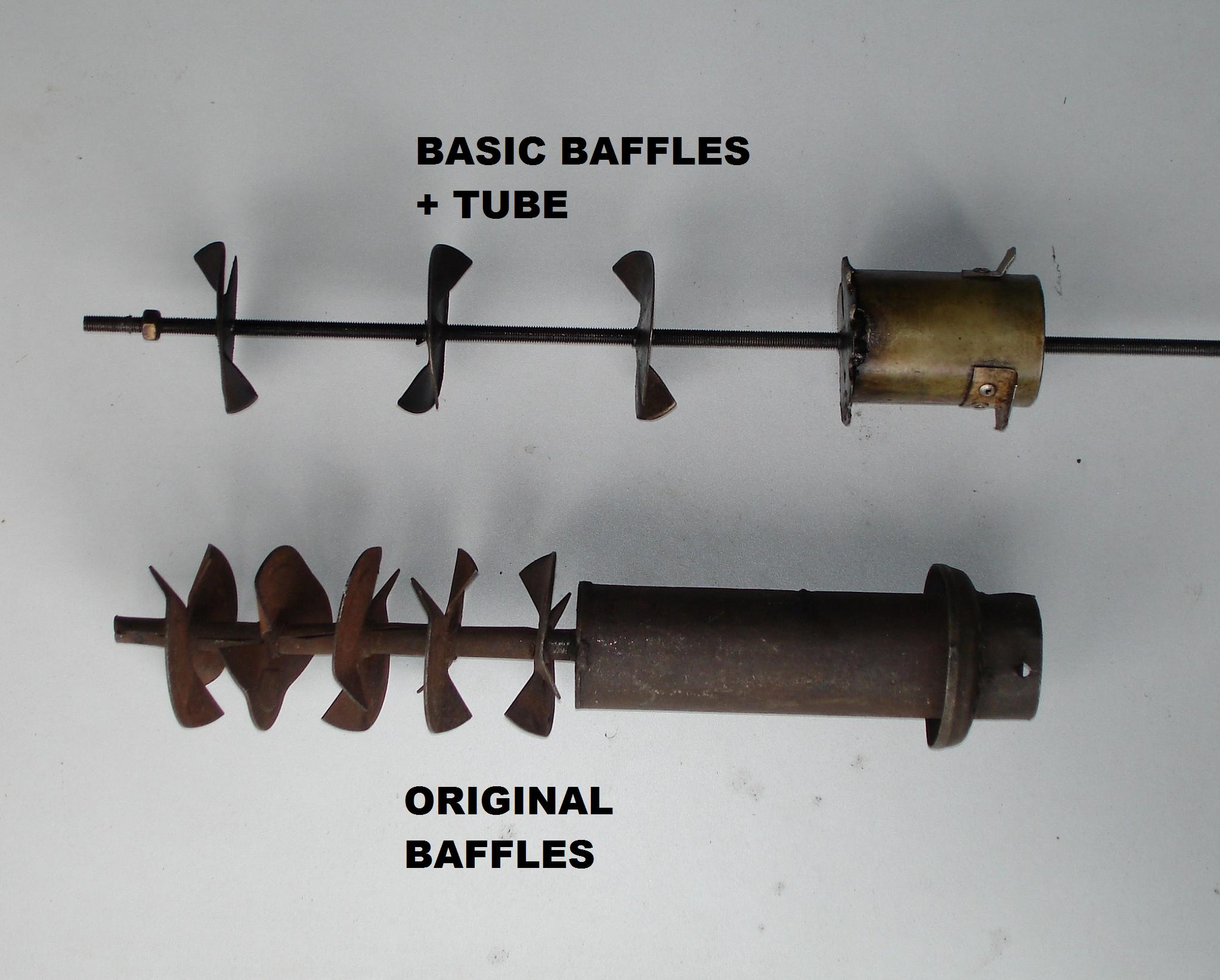

Following a final attempt I have given up with the Amal carb. It kept flooding even with a new viton needle valve and seat. The float was a newer plastic one. Just fitted a new Mikuni carb and started with no adjustments! I think after 60 years a new one was needed. Now need to complete the build and ride it. I was surprised how much noise it made the silencers have baffles in them but no other materials.

If you have a good old search of the two-stroke topics I think you'll find some references to some of the silencers being noisier than others. (I can't remember if that was the Armours ones or not.)

Hi, The Armours silencers have very basic baffels in them, just four discs. You can fit original baffels but need to reduce the size of the baffels slightly. I used some end tubes , the 1'' diameter ones to reduce the sound a bit. The picture shows the original ones at the bottom and some modified Armours baffels at the top with a large tube into which the smaller 1'' diameter tube fits. The sound is not quite the same as the original but close and I think especially with the larger carb it does produce a bit more GO . Brian H.
