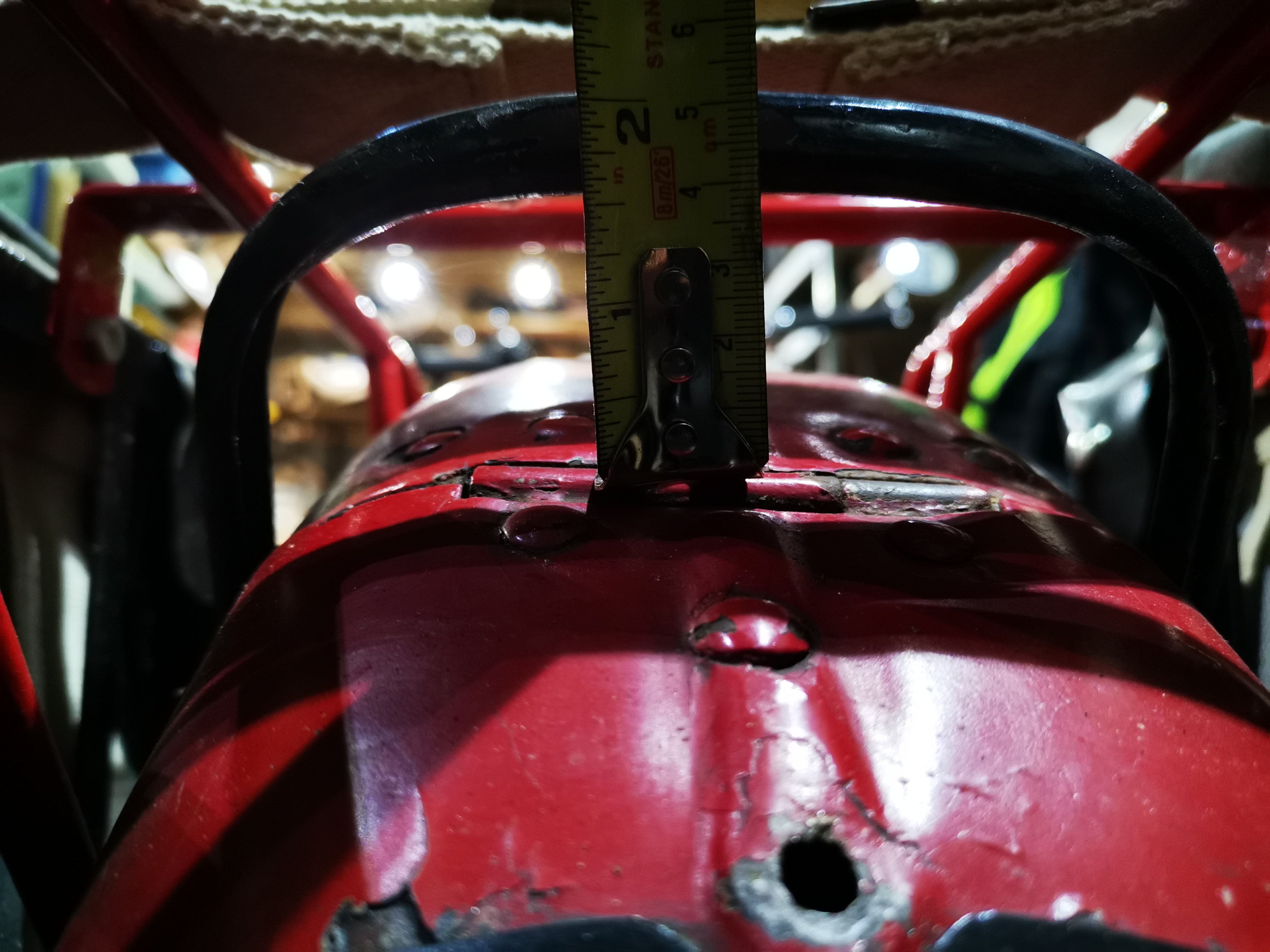

I have an original 42 W/NG and a 30 Model A. If the lifting handles from either of these are suitable I can measure them for you, but I'm not sure which one you are specifically after.

That would be amazing please? Its for the WNG that I require. Mines a 45 but it should be the same for all.

Not ideal but hopefully better than nothing!
