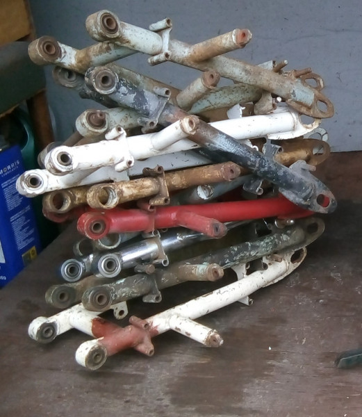

For anyone carrying out a rebuild of their Leader or Arrow I would strongly recommend that you check that the swinging arm is not bent or twisted so that you can get it straightened before you have it painted and fit it to the bike when you might notice the rear wheel is leaning over, or source a straight replacement, but be careful if buying unseen as I've been caught out. In particular the early 'D' shaped swinging arms are more prone to twisting than the latter 'Round' type although I've found some of the round type twisted also. Have had to have four straightened to use on rebuild projects of late but that still leaves me with a pile of twisted swinging arms, all these in the photo are twisted/bent.

What's the main cause of the twisting, Jess - I can't imagine its torque ?
Just not strong enough for side forces on Britain's pot-holed roads ??

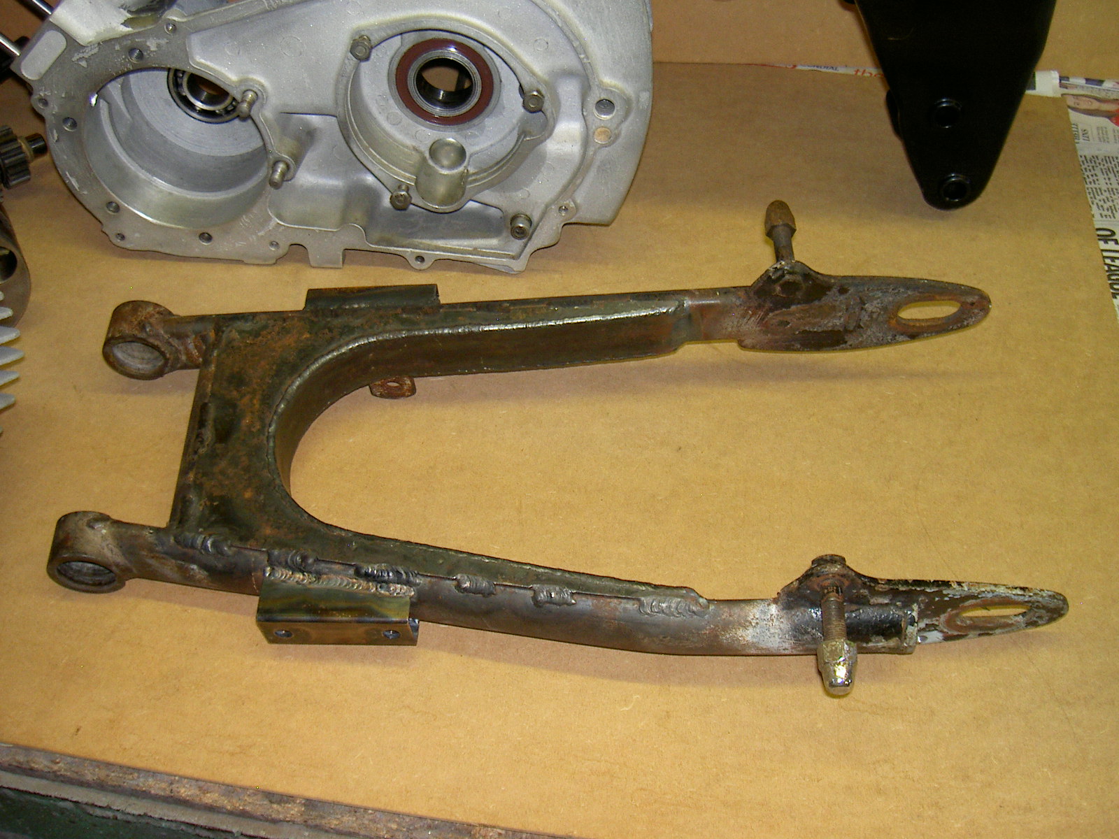

Just not strong enough Bob. Have a look at the attached photo, cross section cut of a 'D' shaped swinging arm at the thickness of the metal. You can see why the pillion footrests droop down eventually. Jess

Simon, I do have a 'tame' swinging arm straightener, unfortunately having just spoken to him about straightening one for you, he can't, he cannot take on anymore work, he simply has too much on at the moment, he sends his apologies. The attached photo is of two Round type swinging arms that have been converted for rear set operation similar to how the Ariel Factory did it in 1961 for the Arrow Production racers that they made for Dealers who entered them in the long distance races, the Thruxton 500 miler and Silverstone 1000. As regards adding extra gussets, the most common way is to add a plate top and bottom of the front cross member, sometimes boxed in, the attached picture shows the style, this is a cardboard template that gives you an idea of what its like, note though this has an 18" wheel, the standard 16" wheel wont be so close. others add gussets down the sides also as per the third photo, perhaps not really needed but they are just making sure on their racer it wont twist. You will only be able to add the gussets at the front on a road bike if you are prepared to shorten the length of the inner mudguard, for a road bike go for a Round swinging arm and you should be o.k. Jess
